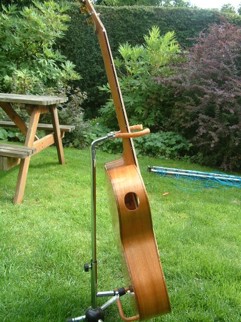

Carpathian and Myrtyle will be an interesting combination and should work well. The bloodwood binding on Peterm's sitka/myrtle guitar in the post I linked to above looked mighty tasty to me.
I'd seriously consider a soundport like this one:
I think they work really well with baritones.

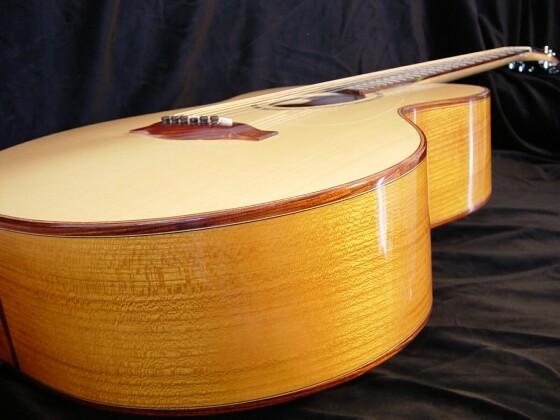

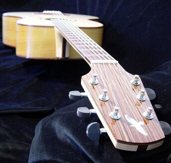

I built a baritone a few years ago on an SJ body, close to a J-185. I used a 28.75" scale (which I think was a 34" bass scale with the first few frets chopped off); neck-body join at the 15 fret, which bumped the bridge back a little bit but not all that much.
The calculations I did at the time suggested string tension reasonably close to standard tuning for a 25.4" scale, though that varied with the string gauge and tuning, of course. After it was built, I played with several string combinations to get the right feel.
I used roughly the same top thickness and bracing as usual, but I closed the X-brace somewhat to increase load bearing along the axis of string pull. I also built it as deep as I could stand (maybe 5.5" when done -- I'd have to check my notes) because a larger volume would better be able to make the low notes we're after.
I used a stiffer adirondack top and osage orange b/s and was pleased with the result. Still seems to be holding up just fine.
Myrtle is lovely stuff to work and should be fine.
I found a couple pics, which I'll include if I can. The appointments are all African kingwood; the uneven ebony pins were temporary as I had yet to turn a few from kingwood.

Thanks guys, sorry for the marginal pics but they were a last-minute thing.
There are several papers that detail "scaling" of stringed instruments, mostly in the violin family, but a general rule is that you need a bigger box to produce lower frequencies which I think makes sense. So I don't have any rigorous basis for calling the instrument more or less successful than a more shallow one, but it seems to work fine.
The instrument was commissioned, so I only got to play it for a week or so. But the tuning you want to target will depend on the scale and string gauges you use.
